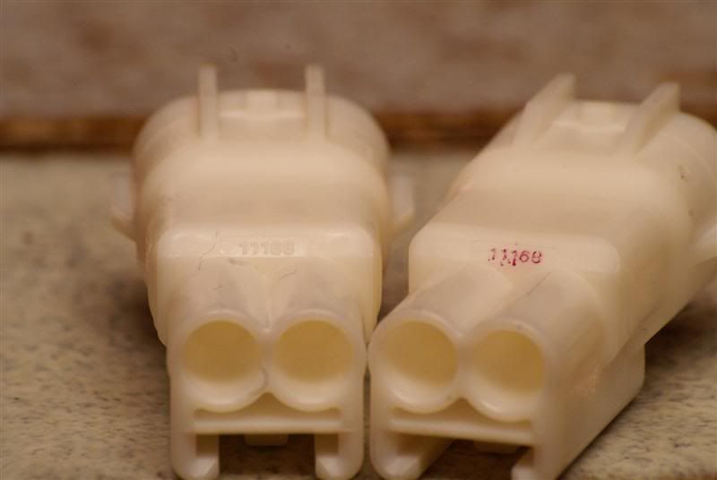

On your plug, there should be 5 numbers printed on it, usually on the back. These numbers are the last 5 digits of the part number. The first 5 numbers of the part number for the plug, is ALWAYS 90980-. Here are a couple pictures of some plugs, a male, and a female. For reference, the white plugs are male plugs for a Tacoma Lisense plate, the grey female plug is for a turn signal harness for a Tacoma.
The part numbers for the white plugs are 90980-11168, the part number for the grey plug is 90980-11020. Make sense so far?
